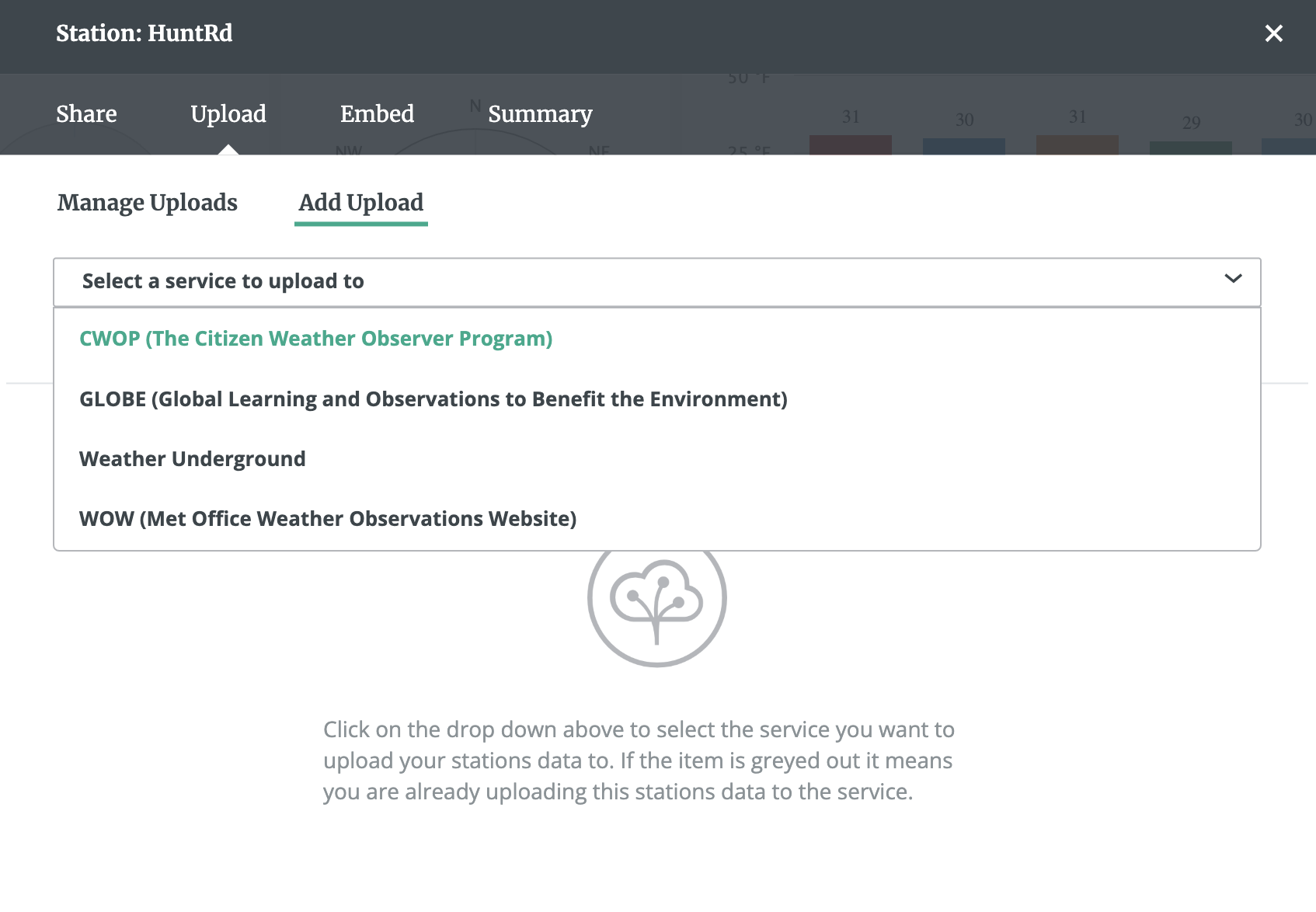

I have the Davis WL console. From the Weatherlink site these are the options for sharing your data::
