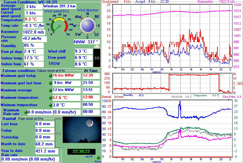

I have noticed an occasional problem with the outside temperature recorded on my VP2. Outside temp reading changes to - - -.- approx every 30 seconds and occasionally the humidity and dewpoint reading on ED spike - see attached screenshot at midday and incl unrealistic max temp - I believe the data is coming from the VP2 rather than any issue with WD.

The day max etc on the VP2 agrees with WD and the TEMP OUT intermittently ‘disappears’ which is what makes me think its the VP2 rather than WD.
