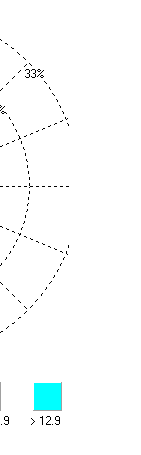

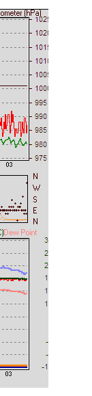

I have notised that with Vista will the right be lost from at least some of WD-created images like my attachments. Is there something to do to that?

you can increase the width of the graph window (i.e when you go to view, graph history)
and then that new width will be remembered
in a recent version of wd
Yes, I think it is a Vista thing too because it appered when move over to Vista. And I think it have been there all the time I have had Vista, I have almost forgotten it but remember it again when looking in webfiles-folder :roll:

is it all files, or just the graph files?

it seems to be on all files and appears on files witch have content near the left and bottom like the directiondial I attached.

seems like vista needs a bit of stretching needed for the width of the form
(much like XP had to be for the height if the extra high window title bar in use)
if you changed to xp appearene it should fix it?
I will test that now and tell you how it works…
henkka
Yes, to change to xp(SP2) appearene seems to fix it
