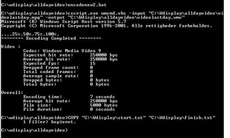

Unfortunately I dont think it helped. I followed Brians suggestions - but I dont get any error. See attached pic of when I ran the encodenew2.bat in DOS mode.
In the screen pic - you can see the dots from 0% to 25% and then only a few dots from 25%-50%-75%-100%
(…25%.50%.75%.100%.)
Right after the bat files gets to 25% it completes very fast.
Maybe that will tell something?
Henrik

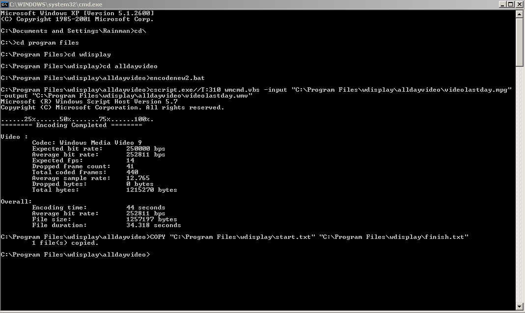

Eclosed a copy of my encodenew2.bat run, might be of some use mine did take a while to run

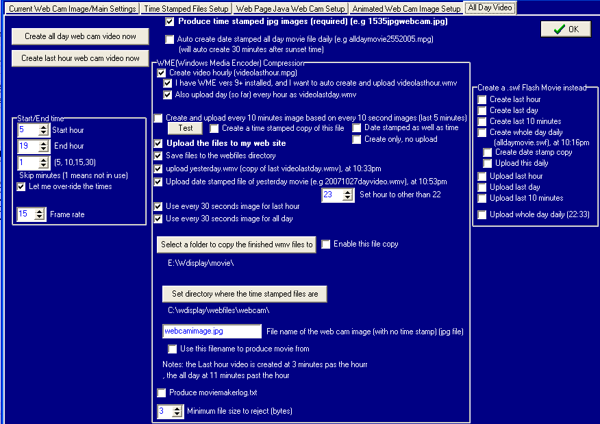

I think its now time to see the screen shots of the settings, there has to be something amiss

I have checked the WD webcam settings many times - and the settings are excactly the same as my settings which are working.
