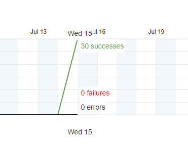

The Wunderground API seems to have suddenly gone offline for no apparent reason last night around 6 pm, leaving everything offline & on Wunderground there is a dramatic drop to 0 successes & 0 failures.
I have tried regenerating the API & it’s just simply not responding to the website at all.
Anyone had the same problem?

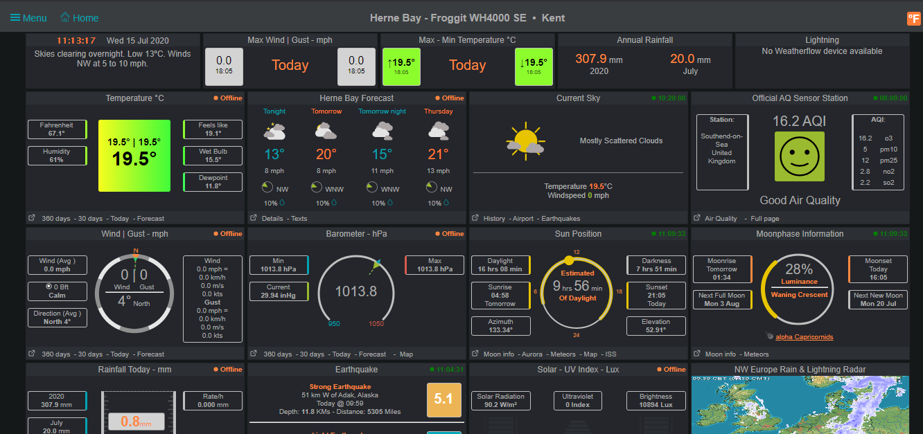

Go to http://kenthcwx.vastserve.com/live/PWS_module_test.php => click button “load files”
The error messages are identical for both WU requests
PWS_load_files.php (374) WU-ccn________: time spent: 0.0255 -  invalid CURL TCP connection reset by peer https://api.weather.com/v2/pws/observations/current?stationId=IHERNE120&format=json&units=m&numericPrecision=decimal&apiKey=_API_SETTING_
PWS_load_files.php (374) WU_forecast___: time spent: 0.0176 -  invalid CURL TCP connection reset by peer https://api.weather.com/v3/wx/forecast/daily/5day?geocode=51.37,1.11&format=json&units=h&language=en-GB&apiKey=_API_SETTING_
