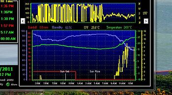

On the bottom graph on the WD Main Screen the UV value is not not being displayed correctly, but is displaying what appears to be the Heat Index instead (see attached image). If I use the mouse cursor across the graph the graph displays UV correctly just until the next minute update of the screen occurs when it returns to displaying the Heat Index again. The UV value also seems to display correctly when the screen captures are made (in my case every 15 mins).

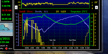

Interesting; I’m using the latest version and have the UV on the graph like that and it’s displaying just fine for me…
