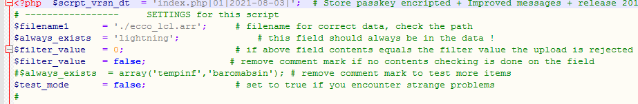

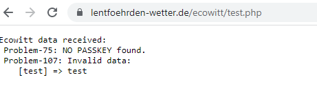

Hi Wim. Here is result of https://lentfoehrden-wetter.de/ecowitt/ecco_stats.txt , two lines 4,6 were changed. Third pic is a test.php. What is wrong? Thanks
There will always be random upload errors once or twice / day
As far I can see the uploaded file is OK
https://lentfoehrden-wetter.de/PWS_listfile.php?file=ecowitt/ecco_lcl.arr&type=arr
The timestamp is in UTC
    [stationtype] => GW1000B_V1.6.8
    [dateutc] => 2022-01-18 11:29:53
    [tempinf] => 68.7
    [humidityin] => 51
    [baromrelin] => 30.481
    [baromabsin] => 30.481
    [lightning_time] =>
    [lightning_num] => 0
    [lightning] =>
    [wh57batt] => 3
    [freq] => 915M
    [model] => GW1000_Pro

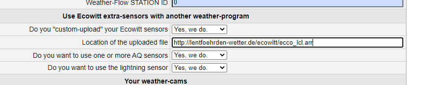

Hi wim. Did everithing as discribed, second solution. Still doesnt work, eny idea why? Thanks
Screenshot 1: The location CAN NOT be an http address.
You are talking on the PHP level, not on the browser address level.
Screenshot 2: Correct, normally we use ./ecowitt/eccolocal.arr
Screenshot 3: Is correct.
Please check the uploaded data: . . ./PWS_listfile.php?file=./ecowitt/ecco_lcl.arr&type=arr

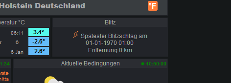

The lightning-device exists and the data is received and uploaded by the gw1000
The lightning-device did not register any lightning yet.
=> all values are zero.
And in computer terms, the date-time with the value zero = 19700101T000000 UTC
Januari 1st at midnight UTC time.
New lightning data it is displayed in the blocks.
As the GW1000 can be reset (power failure or new firmware) the latest value of the lightning is saved in the history file.
So we have to wait until there is lightning displayed.
Use the ws-view app on your phone/tablet and check the values of your GW1000.
There would be an problem if the ws-view app showed different data for lightning.
