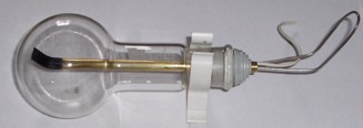

I have been playing around with another solar sensor mounted in the laboratory flask
I found in my garage a old thermostat. The type that are used in copper hot water tanks
I cut off both ends which leaves you with a brass tube with a metal strip inside which is used as the differential
when it was originally used as a thermostat
I have squashed one end which has curve on it and I have soldered this so it is watertight
next I made a half inch washer using some plastic piping and heat glue mounted the brass tube in the centre
this acts as a seal and it also helps to position the tube
I cut a small hole in electrical Gromit plug, feed the temperature probe through the rubber plug and then into
the brass tube pushed everything into laboratory flask keep the other end of the brass tube open
Take, the thin strip of differential wire and form a loop with two long leads protruding
these leads are pushed into the brass tube
The idea is as soon as a cloud moves in front of the Sun the flask will cool down very quickly due to the differential
in the two metal materials used and one of them is more exposed to the air outside of the flask
heating up will be just as quick
I do not have a spare extra temperature sensor, do you want to try this out I have no problems with posting this out on loan
if it works and improves the results you are after just need you to send me a replacement flask
mick :slight_smile:

I have received Micks new modified solar housing which looks great and it looks like it will do the
job very well, as soon as i can find a 2nd hand temp probe i will do some testing, the reason for
2nd hand is my console can only take 3 extra sensors and im already maxed out so buying brand
new will just be wasting money as i wont be able to use it all the time, once testing is complete
that temp probe with go in the drawer :frowning:
