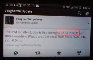

Now that I have twitter up and running it seems some characters are missing or incorrectly displayed on mobile devices
This is the WD code to generate the twitter feed:
%time% %metarcloudreport% & %weathercond% sitting @ %temp% with %hum%% humidity. Winds are %avgspd% from the %dirlabel%. Total 24hr rain %totalrainlast24hours%
And this is what my web based twitter feed looks like
VaughanWxUpdates
1:00 PM mostly cloudy & Dry sitting @ 22.5

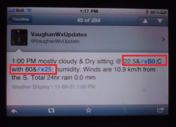

Just discovered it seems to only be happening through the default twitter client for mobile devices, the mobile website works fine & other clients such as tweetdeck mobile & desktop work just fine too.
Now I’m scratching my head!!! LOL
Obviously a Twitter and Twitter Client issue…
It seems the problem stems from the humidity % symbol and the temperature

Nobody has ever been able to solve it - the strange thing is that Cumulus Twitter feeds work ok, it only seems to be a problem with Weather Dispay, and only on iPhone/iPad Twitter apps.
It’s annoying but WD is so useful in so many other ways that I’ve just learnt to live with it, by deleting the offending characters.

That thread was exactly the same thing I was encountering. I followed the instructions to turn off the units and everything is working fine now.

I got around the weird letters and symbols coming up with the degree sign but when I put a % behind the %hum% tag in WD the jibberish still came up so I just used dew point instead.

The only way I (& others) have been able to get around this problem (only affecting Twitter on iOS devices) is to set not to show units, and in the Twitter string use “C” rather than "

Only in that we can’t include the degree or percentage symbols because they don’t display properly within iOS applications. I can live with it.
