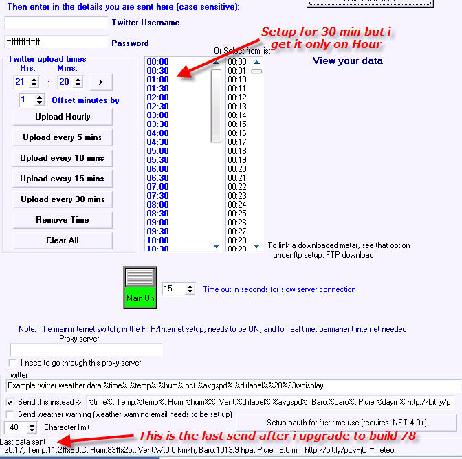

Running WD 10.37Q build 71
on a fresh reboot of the PC Twitter feed is send every Hours despite it is setup for every 30min.
after approx 48h i am missing some hourly feed specially at 02hAM then after missing 1 every 2 or 3 hr It stop.
If i stop WD and restart i will only get a send as soon as WD is started as it show in twitterData.txt but it is not send. I must reboot the PC every time to get it going
0.37Q build 78
Any clue on the issue.
Just updated to Build 78 before this post and it sent only once. I had to reboot the PC.
I have included a snapshot of my setup

Here is what i received on Twitter, since 00h00 sep 17th , 00,01,03,05,06,07,09,13,15,16,17,18,19,20,21,22,23 Sep 18th 00,01,03,04,05,06,07,08,09,10,11,12,13,14,15,16,17,18,19,20,21,22 Sept 19th 00,01,04
so on Sep 17th i missed 02,04,08,10,11,12,14, on Sep 18th 02,23 and then today 02,03,05,06,07

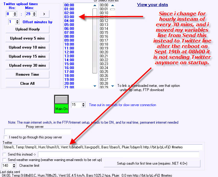

This morning at 08h00 i have change every 30 mins to Hourly and moved the variable line from Send this instead to Twitter line and untick Send this instead. I saved every thing. Stop WD and reboot the PC.
Now it is not sending any Twit. Normally on a restart of WD it is sending a Twit.
Just change back from hourly to every 30 mins and rebooted the machine and i saw the Twit going out at 08h43,
So i think there is one problem within WD when we choose hourly only it does not work.
