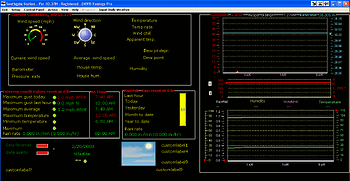

About 30 minutes ago I noticed that the temperature on my website was not current so I stopped WD, deleted the repetetive data and restarted WD. Nothing happened. I then restarted the PC and started WD and nothing happened. The datalogger was on the screen for about five minutes before I aborted the mission. See picture.There’s not any “weather” happening so the only thing showing any great change is the anemometer and the temperature and they seem to be working. Where should I start to look for what may be the problem?

“Data received 0” = WD has lost contact with the logger. First checks would be the physical connection and whether any other program might have hijacked the com port.
