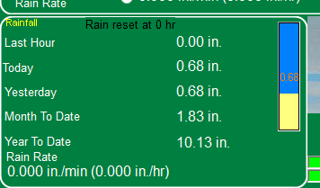

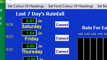

The current Today rain total on my WD dashboard also shows up in the Yesterday total. This occurs even though within WD on the View Panel Rain Chart, the correct Yesterday rain total (0.01 in.) is showing. This error then also appears on my Sartoga site. Any suggestions on how to correct this?
Right click on the Rainfall area but choose “Offsets and Rainfall Adjustment” instead of “Rain Last 7 Day’s [sic]”. Under Temp./Baro Offsets/Rain Totals tab you can enter new totals for today, yesterday, monthly and yearly rain. Check the box beside each for Inches and press Set for each correction. Then Yes at top right to save the settings. Job done.
You can also edit the Detailed Rain Data from the 7-day screen, top right.
