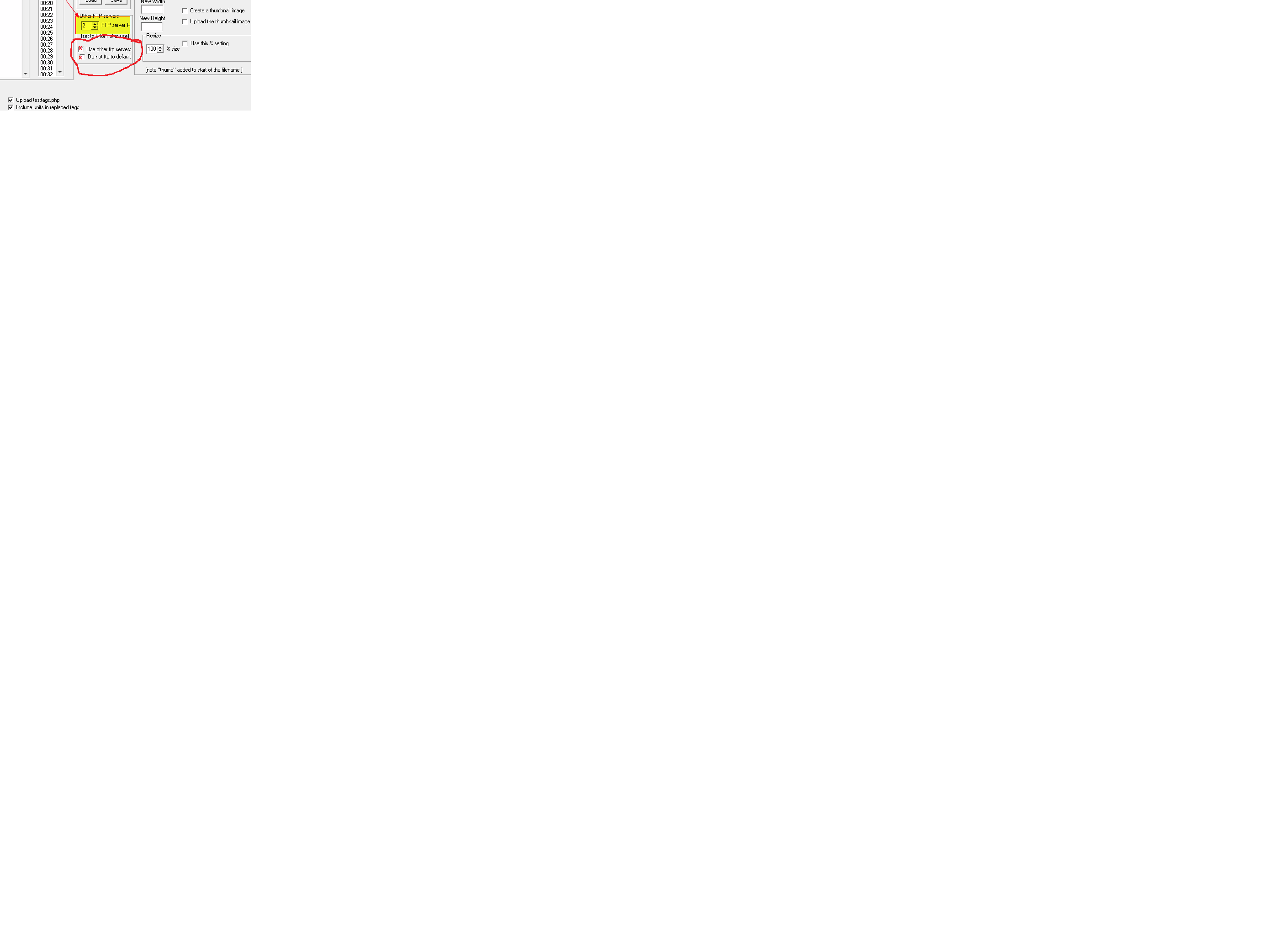

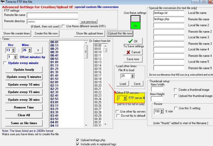

Are the settings on the below screenshot correct?

Below the "Other FTP server you must “tick” “check” “use other FTP server” and if you only want it to go the second server then also “tick” “Do not FTP to default”. Also make sure you have the correct information entered for your second server. I just went through this setting up a new website on an additional server.
Good luck
Cheers
:smiley:
MikeyM
Thanks MickeyM.
I ticked both and it’s working. :lol:
