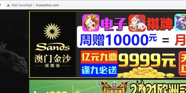

SPAM warning
The link in the avatar is not a valid link to a weather website.
It seems to be a gambling website in the Chinese language
If you are a valid user, please post the link to your dashboard website
I’m guessing that the site has been hacked. The user registered on the forum in 2010 so I think that would be a long shot to wait 12 years to become a spammer!

Agreed, i got a link to industrial products, the member has been hacked for sure.

This link is for your WF-station dashboard. Not usable.
Your Avatar link is for another template Magyarország Home Weather Station (wf version)

The link in your avatar does not show a PWS Dashboard , so no support for that is available here.
If you are running a PWS Dashboard please post the URL so that we can see the problem.
