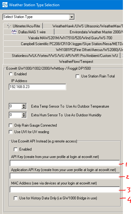

You can get an API key from Ecowitt. Then on the Ecowitt GW1100 setup page you fill in the details and tick 4 to get history data. Don’t tick Enable or you use the API to get WD “live” data.
At least, I think that’s how it works: broadstairs might chip in, he’s a Ecowitt guy.
So am I an Ecowitt guy and yes thats correct. Its stores all the data, so when you turn WD back on it will download all the data that its missing.
I know this as I once turned off WD by mistake one evening and then next morning realised it was off, and BANG it downloaded all the data.
Also it might be worth while settings the ecowitt GW1100 to static Ip if possible so that WD has the correct ip all the time.

What is the difference between the API Key and the Application Key.
I have an API key from Ecowitt.
There is a huge amount of information about Ecowitt on the WXForum and specifically this thread MUST READ Fine Offset clone models incl. Ecowitt which I know is a huge read but well worth the effort when initially starting to use Ecowitt kit. It answers so many questions. For this see item labelled 14.
I’ve read it, and I still wonder about the application key. . . do you make it up yourself, so that you can distinguish between API calls by different applications? (I presume you get a different API key for each AP key.)
EDIT: looks like it, now I’ve looked at https://doc.ecowitt.net/, as recommended :roll_eyes:
Just to be clear for anyone reading this you get a API Key / Application Key pair for each gateway registered on Ecowitt.net and this can be obtained by viewing your data for the gateway on Ecowitt.net using the right hand side menu under user name and selecting User Profile where the keys are displayed and can be copied.
