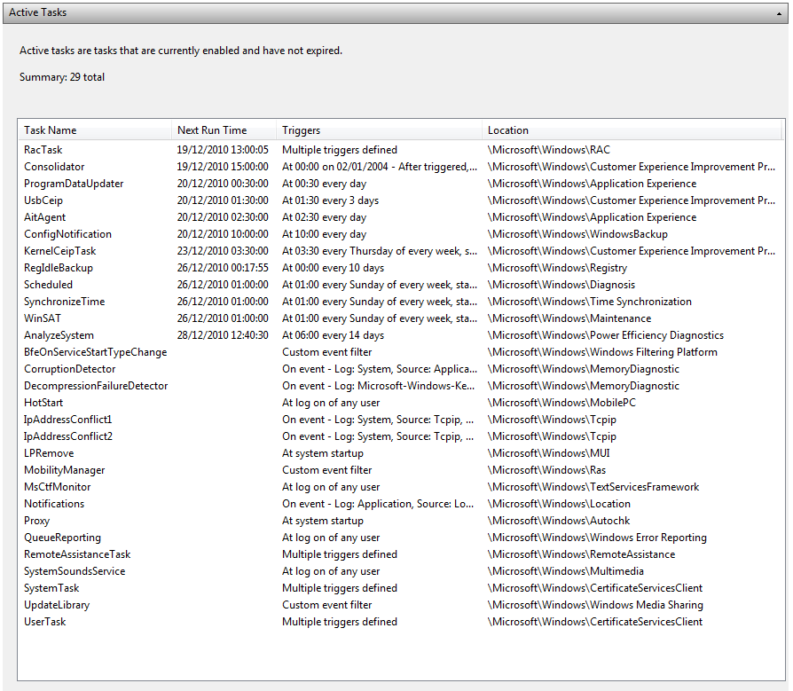

I have checked my Win7 event scheduler and there is nothing listed that runs every Sunday at this time.

I agree it must be a Windows scheduled task of some kind but I am not sure what, I have attached a screenshot of my task scheduler - I can’t see anything obvious although I probably should review each one and disable any if possible.

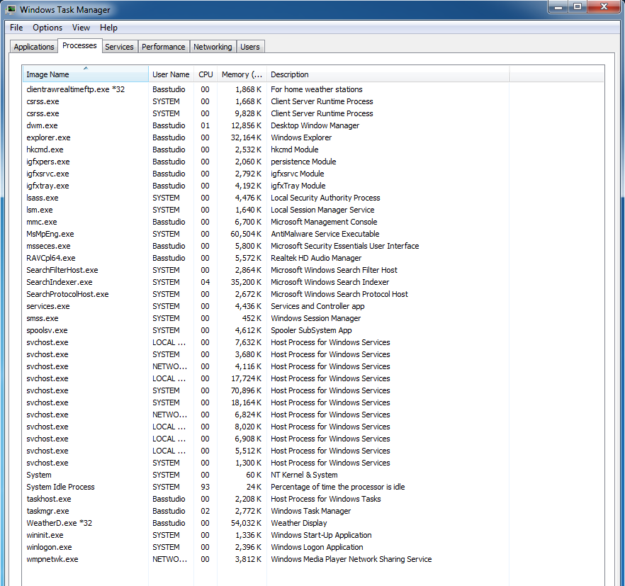

What if any applications (ie. non-system programs) are you running 24x7? All those in the screen shot are Windows tasks. Often there are other applications running which are not Windows system tasks and they might have their own schedules which are not in the Windows scheduler.
Also I doubt that the other thread referenced will have any bearing on this :wink:
Yeah good point; nothing else has really been installed except for the Realtek audio drivers/panel and the Intel drivers/panel for the motherboard and gfx, both of which I can’t find any check for update options etc. I have attached a screenshot of all the system processes running. I have just disabled the googleupdater from loading at startup but couldn’t find out when it schedules its check.

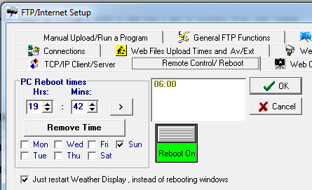

check the reboot times in the ftp/internet setup
Yeah this looks like the suspect, thank you. :smiley:
I have turned this feature off and I will report back in a weeks time. I guess for some reason WD is not restarting properly under Win7 or something with Win7 is causing WD not to restart correctly.
