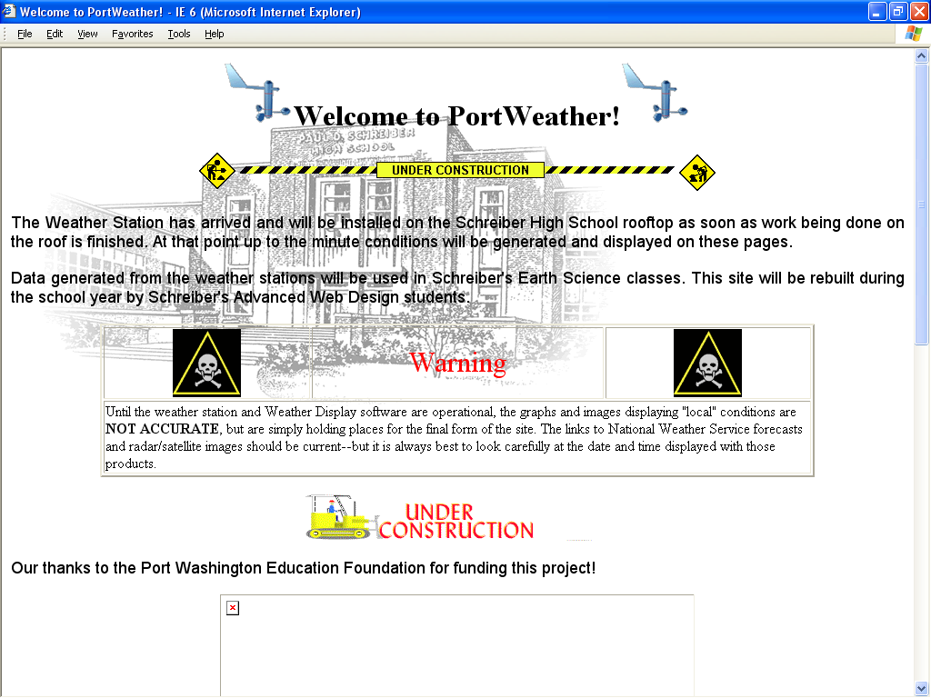

  1. That same page (wx2.html, the right frame in my index.html file) is displaying distorted in IE6. Looks fine in IE7 and Firefox. If anyone with IE6 can spot what’s wrong I’d appreciate the input.

The file is clean in IE6 when viewed alone. When in the frameset, the right side of the frame is black (especially viewable on a wide screen monitor), the table with the warning/skull & crossbones repeats, and when the page is scrolled it smears badly. I’ve never seen anything like it. Have a very similar setup on my personal weather station page (msweather.net) and have never had a problem. Thought it was my video card, but the problem was there from another computer I used to check it. :?
Two possible causes.
  1. JavaScript menu’s ?
  2. The frameset you are using does have validation errors as well which may effect IE6.
