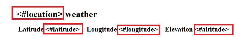

Like the image below, there isn’t any word on the #location, #latitude, #longitude, #altitude tags.
Should i put my data into gauge-ssT-it.htm?

The tags are working tags for Cumulus i think, they don’t work in WD, or you can just fill in the fields.

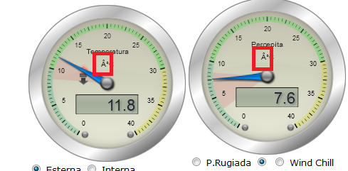

Hi Mark, I've another question. Like the image below, i don't manage to fix the wrong character near the temp unit.....what can i do? Second thing. I've set the code to show the trend graphs like this: Code: [Select]var g_imgPathURL = “./flashgraphs/”; //*** Change this to the relative path for your ‘Trend’ graph images

Alessandro, I think you have a character set mismatch. Your page is declared as “charset=ISO-8859-1” but the steelseries scripts are using UTF-8.
Again you are also mixing HTML standards, your page is declared as xhtml but the gauges are coded to HTML5. The page will not w3c validate as it stands.
