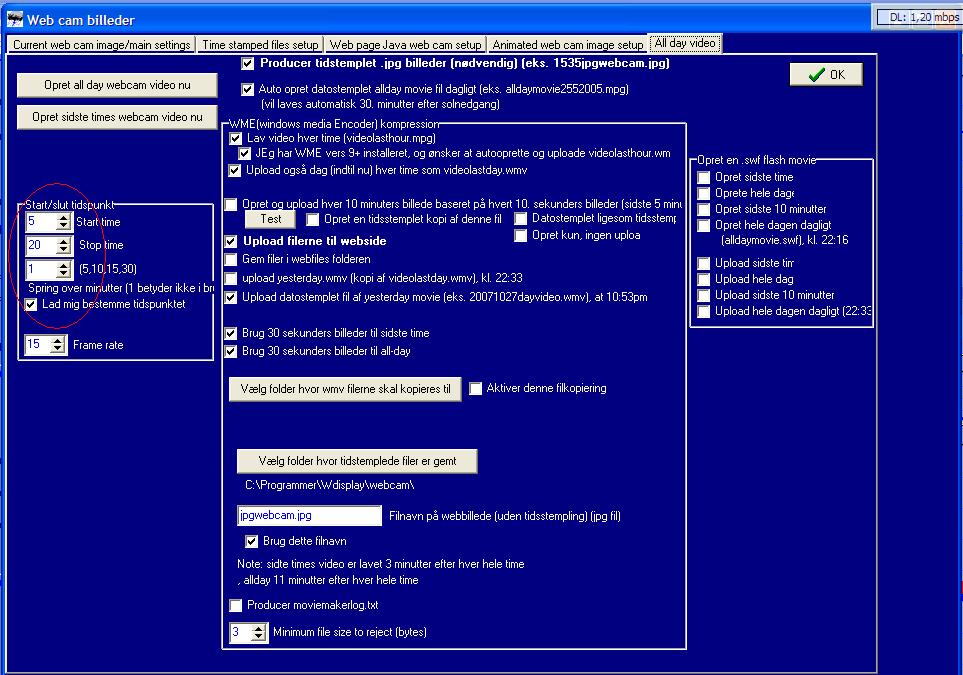

Is there any way to change the start/end time of the daily videos ?
Im finding they are now starting after dawn, and so am missing some nice sunrises at the moment.
You can set the time for all day video in “Controlpanel > Webcam setup”
In the tab “All day video” you can set the times you want for all day video and tick “Let me override” (In Danish “Lad mig bestemme tidspunktet”)
See attached pic with a red cirkel.

I will give it a try… mine doesnt have the frames per second on it :frowning:
All I ever saw when i looked at that were the lst hour, so I assumed that it was dfor the last hour video.
Download and install the latest WD version -there you can set frames per second.
