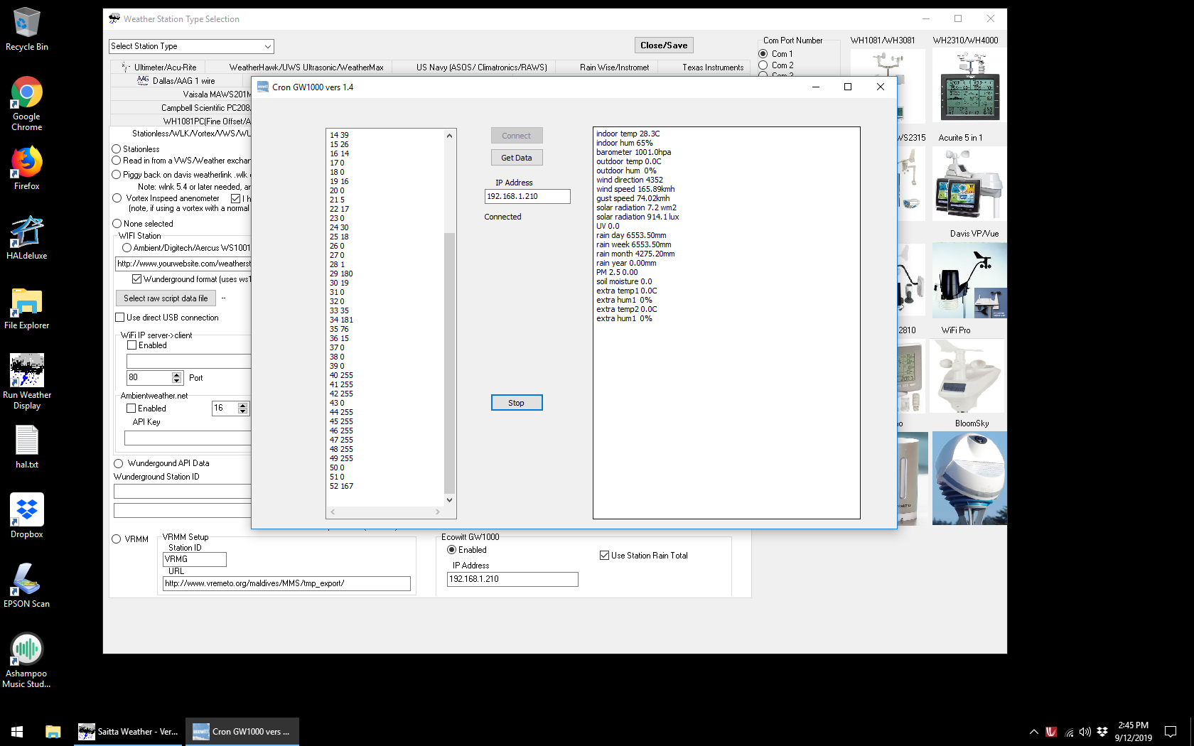

So I ended up for now going with the W1000 paired with the WH40 rain gauge option. Got everything hooked up and the app works. rain gauge is syncd with the w1000 and the app. but when I try and use the W1000 for rain in Weather display I get all kinds of crazy readings when I click on the enabled button and use station rain total. See attached screenshot. I got the IP address from the app on my phone . Any ideas what I am doing wrong here? under the oregon scientific tab I still have WMR200 USB checked

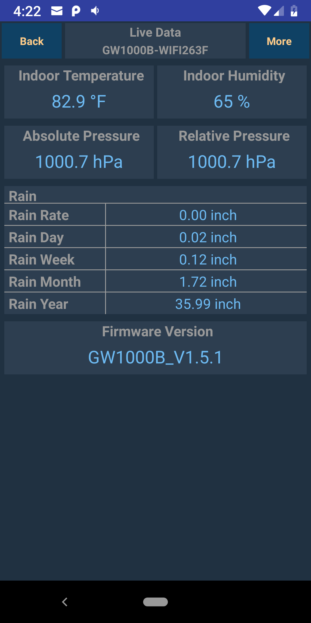

Also Weather Display keeps updating my annual rain to 168 inches. when it is only 36. Screen shot of what W1000 is also attached

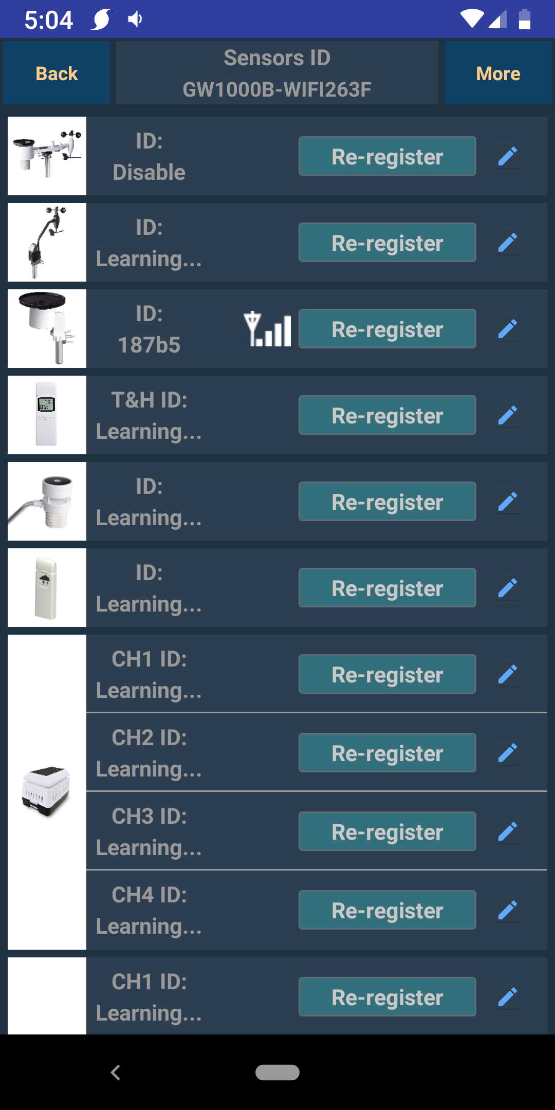

have you setup the app that comes with the GW1000 …does that show the rain guage sensor?
ah crap. then I misunderstood. That was what I was trying to do. Keep WMR and just replace the crappy rain gauge!
For the GW1000…just a rain gauge
So looks like I totally misunderstood your direction. I assumed that the original suggestion was a way to use the WMR200 and just add the WH40. :frowning:
So looks like I am still down a gauge for tracking rain in Weather Display. But I will not look to either add more Ecowitt sensors to the GW1000 or go the route of Ambient WS-2000

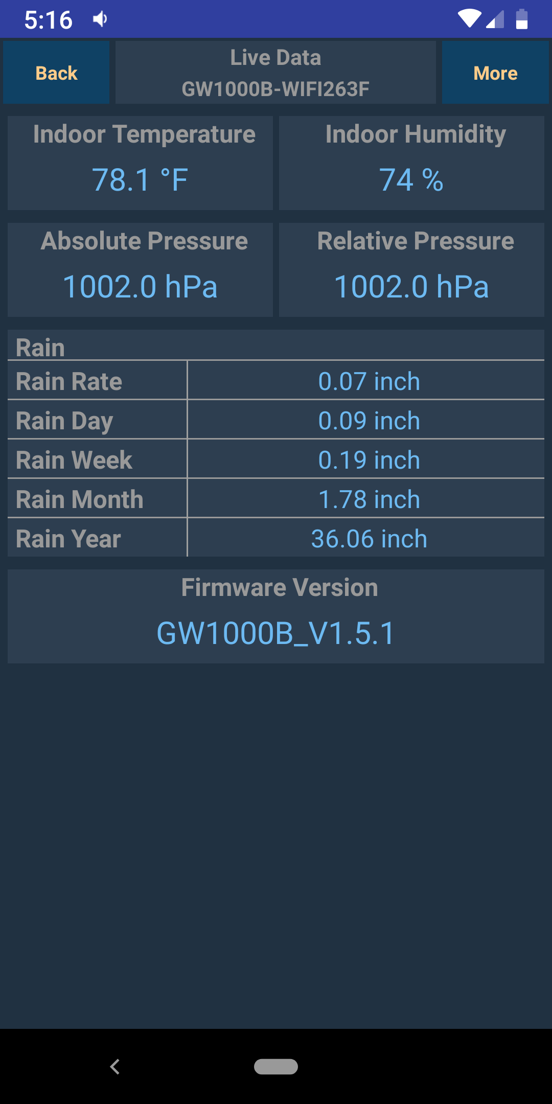

Yes. I just did a reset on the sensor (pulled battery) and GW1000 (unplugged from USB) per ecowitt instructions. Lucky me it just started raining!! I now appears to be recording in the app. Updated screenshot attached
and so does the WD cron program see the rain data values correct now?
How can I tell? I disabled the setting to enable Ecowitt GW1000 since I thought I can only do one or the other (GW1000 or WMR 200). Also each time I enabled it I got very odd data. Winds over 124mph, 258 inches of rain!
you would need to run the crongw1000.exe program (with WD not set to use that)
and see what shows in that program for rain data now that you have the GW1000 actaully set to get the rain data

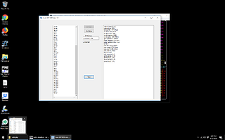

So I found that and ran it and it still pulled in some crazy data. See attached. I have no idea where it is coming from
its only reporting what is in the raw data
which is NULL data (i.e 255 values)
