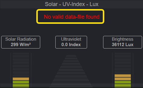

I recently added a Davis Solar Radiation sensor to my ISS and via WD, added it to my PWS ( Arcola, Virginia, USA Home Weather Station (wd version) (novawx.dscloud.me)). I do not have a UV sensor.
The tile I created shows the Solar Radiation from my sensor but has an error message No valid data-file found.
How can I fix/remove the error?

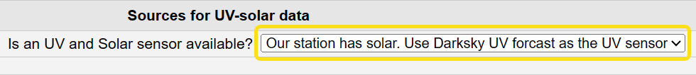

In PWS_easyweathersetup.php, for the sensor option I chose:
And for the tile option I chose:
My guess is the UV needs to come from Darsky but I thought they were defunct and an Internet search indicates they have an app but I can’t find a website.
Yes, message is because DarkSky is defunct. You would be better selecting “Our station has both UV and solar” to get rid of the message. . . I know it means you have to ignore the pyramid and UV box. . .
I have a similar problem because I only have UV. . . I modified a popup to “UV Guide”.

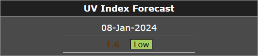

I wonder if the UV index could be populated from TEMIS – Clear-sky UV index forecast and archives similar to the way it is derived from the Saratoga Weather template from the get-UV-forecast-inc.php script?
I have always wondered this as well
The dashboard shows the current weather-values from your weather-station sensor.
Those are realtime values and f.i. UV and solar change during the day based on time ( → height of the sun) and cloud coverage.
The TEMIS-values are a forecast of the “max” values for the day. The values remain the same for the whole day.
So it would be a strange block with values for solar changing based on time of day and cloud.
And a constant UV-value which would remain the same during the day and night.
In the past we used the 1 hour forecast from DarkSky as that one generated “dynamic = adapted to weather conditions” values during the day.
That could be used also if the replacement-forecast for DarkSky also uses dynamic values.
We can not use METAR as not all METAR-stations supply IUV and Solar.
I hope this clarifies the current situation a bit better.
