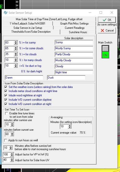

Attached are my Solar Sensor Setup Settings. I’ve tried tweaking them but it still displays wrong summary image and wrong icon on website.
I’m in Western Australia and at the moment thee is not a cloud in the sky, and there has been none all day.
vinesweather.com
Any help or suggestions are appreciated.
Chris
All I can suggest are the settings I use, try them and see if they work:
70% - Sunny
50% - Scattered Clouds
35% - Mostly Cloudy
5% - Cloudy
0% - Overcast & Gloomy
The only other setting we have different are the Averaging, I have set to 2 minutes, which just means my icon will change faster.
