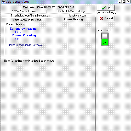

Have just set up my 1-wire solar in a jar and in 1-wire setup it reads reads ok as temp-sensor no 2, and it is added in 1-wire misc as solar. But when I go to solar setup I have a blank screen for “In jar setup” (pic) and in current readings it gives me the raw-reading ok but no %-values (have been at 0% hole yesterday). Some help please.

My set is, Davis Vp2 and added 3 1-wire-sensors of wich 1 sensor is allocated as extra temp #2 and the solar-box in misc settings is putted to 2.
Readings just now: out -5.2 C and solarsensor give me -1.9 C and yes, the solarsensor-reading (-1.9) is shown in “current readings”-tab for solar-sensor, with the settings I have in the .ini-file that should give me about 70% but the reading is still 0%…Any ideas?
