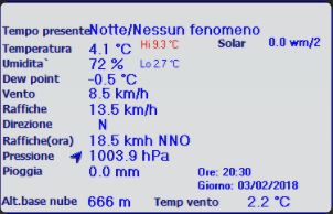

Hi, as you can see my summary.gif has the solar with -----

Sorry but maybe Im not clear: I have solar data, they are simply not displayed in the summary.gif ( displayed ---- )

wh3081 with solar and latest WD (updated today)

It is not night but is a problem that affect my station since longtime (i have the night icon only when it stops to rain otherwise always this)

Many thanks for the support, but sunrise and sunset are working well. After sunrise if not rains, I have the sun icon :slight_smile:
anyway, I attach the screenshot; I live nearby Milan (Italy)

As shown, you have been set to Metar, not a solar sensor.
I’m using this setting.
Interesting… I have applied the suggestion; now I need to wait for the night :slight_smile:

It is working fine! Many thanks to all! Great
So I’m realizing that the Linate Metar (LIMN) it send clear during the night, maybe 8O
