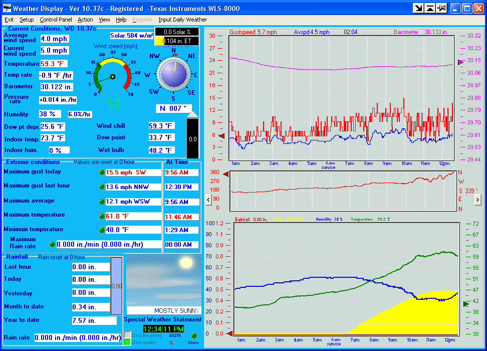

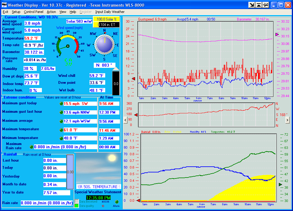

Upgraded last night from 37c-02 to 37c-08.
Today the solar % readout is dropping to 0% every third minute.
It stays 0 for one minute, then jumps backup to 100%.
Then two minutes later it once again drops to 0% and so on.
The conditions gif now flashes at the top of each minute (didn’t before). And at times shows incorrectly that it’s partly cloudly. (It’s currently clear blue sky)
The solar % reading is also being reflected in the clientraw and WDL.
The solar Graph is flatlined as well.

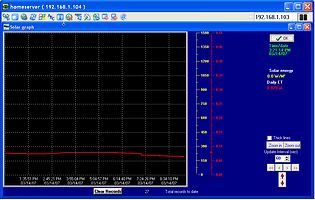

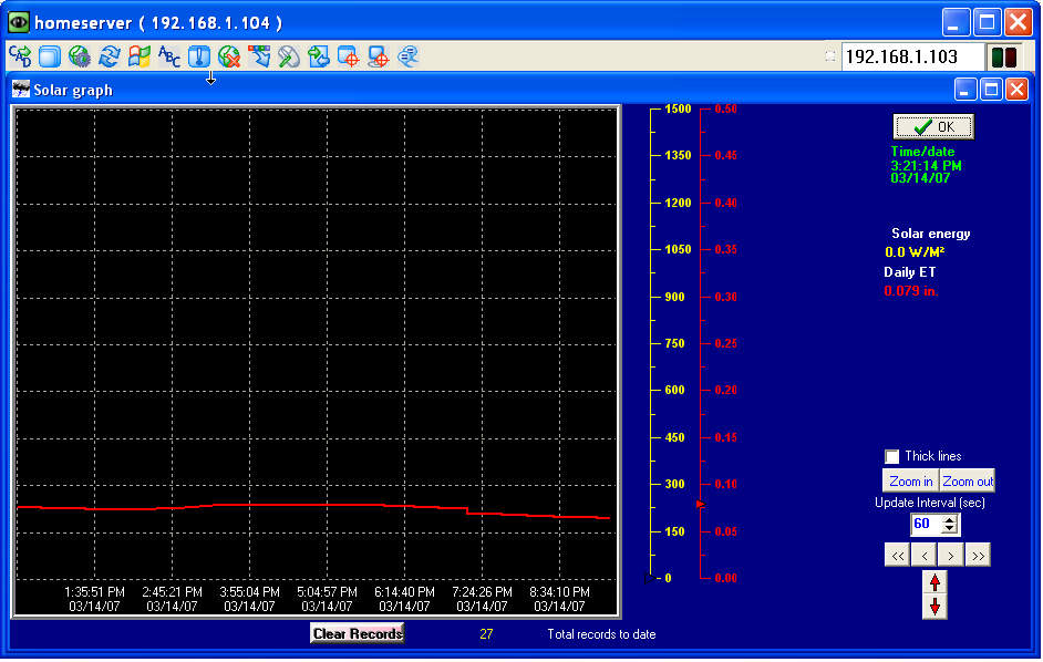

See attachments.

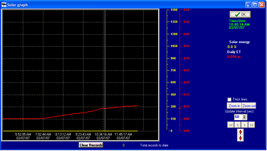

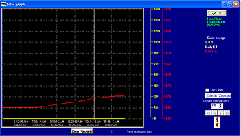

Thanks Brian, this update fixed the Solar % dropping to 0 every couple of minutes, but the Solar Graph still flatlines. See attachment in first post of this thread.

i see you have set option to plot solar % on the solar real time graph instead of solar wm/2
i wonder if that where the problem is
does the solar % show ok otherwise in the solar setup, current readings?
Mmm, that’s probably just from some futzing around I’ve done at some point. Not sure why I’d change it.

Changed setting to graph wm/2 instead of % no differance. Still does not graph.

See attached.
