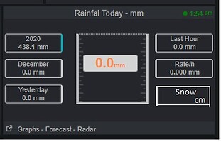

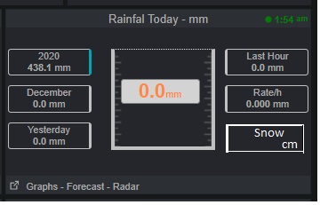

Hello,
It is possible to have data about the fallen snow in the rain_c_blok.php block, possibly as I put in the next image.
Thank you.
Marian.

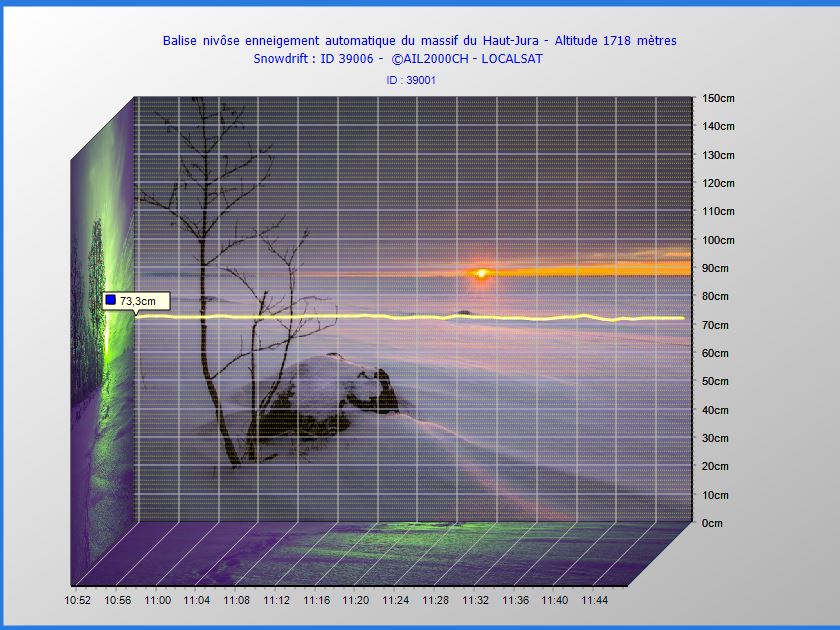

Hello,
I’m using a snow depth sensor, and it’ll be great if it works live as it does now via a graph from WD.
Serge
If you upload that graph-image to your website, you can easily show that image in a pop-up.
Now we are discussing how and what to add inside an (extra) block on the dashboard.
What are your ideas about that?
Regarding this graph I wanted to show you that it snows in places. Regarding my application I will be interested in a block that indicates in text the height of snow in real time as well as the accumulation in the day and annual.
Serge

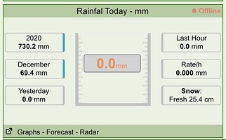

Ok, first some facts about the rain block. It can have three low items at the right
==> which are displayed when the weather value exists
These are the current used items:
  • rain_lasthour will be displayed even if it is zero
  • rain_rate will be displayed even if it is zero
  • et_today “evopatranspiration” will be displayed even if it is zero
  • leaf_wetness will be displayed if there are less then 3 items, even if it is zero
The snow-height and fresh snow-fall can be displayed if there is room for it.
See attached screenshot of the adapted rain block.
There is only room for one snow-value inside the border, I display “Fresh” if there is snowfall, otherwise the current height will be displayed.
Possible adaptions:
  1. Need to enter a snow season, otherwise the last recorded snow height will be displayed.
  2. Only display “rain-rate” and “rain_lasthour” if the value is greater then zero. That will give us more room.
  3. make a smal block into we can display at least both values
As I understand it?
This is well in: rain_c_blok.php block and only works on: PWS_Dashboard 2012_lts?
