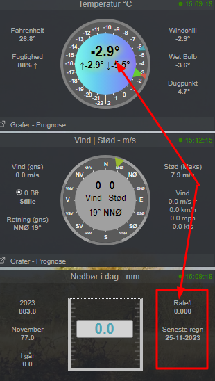

For some reason, snow depth is no longer displayed on my template.
A few days ago I could see it, and I don’t think I’ve “tampered” with anything.
I use the dashboard script to write current snow depth, which is 2 cm, and the temperature is below 5 degrees Celsius, - but no display.
I wonder if it’s something I can fix.

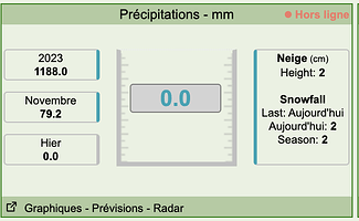

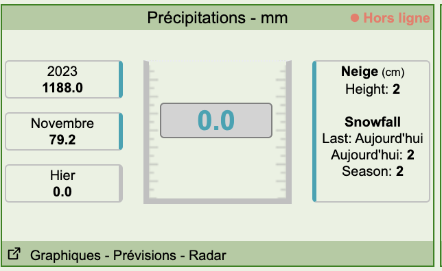

Current releases use PWS_livedata.php to load the snow into the weather array

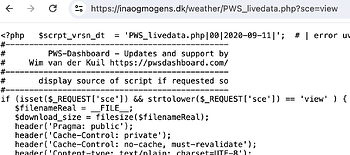

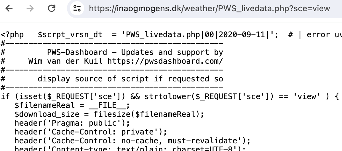

Very strange, when I check your scripts you are using a very old one
<?php $scrpt_vrsn_dt = 'PWS_livedata.php|00|2020-09-11| # | error uv solar | DWLv2api |windrun | standardized $et_today |release 2004
That release 2004 script has no snow features in it.
Please check the source, no code for loading the snow-file to put into the weather array
