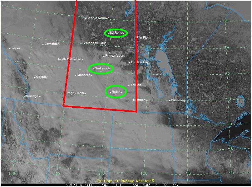

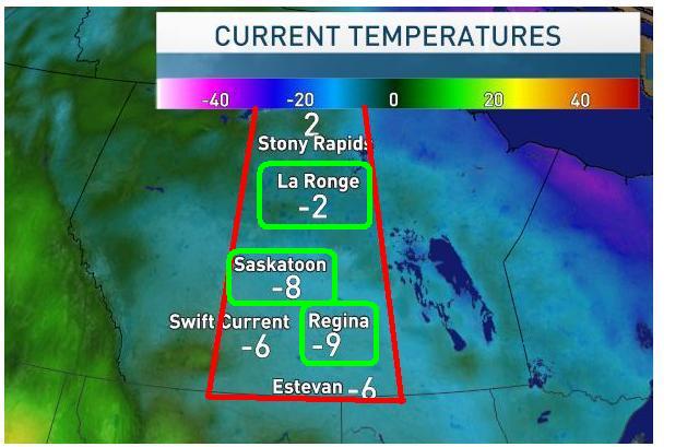

Just a followup to my comments above.
Here is a perfect example of how the coniferous forest influences temps. See attached pictures from Mar 24 on a basically clear calm day in the entire province. The area of warmer temps in the north of our province corresponds nicely with the forest cover easily seen in the satellite photo. The white that shows up in the south is snow pack with only a few wispy clouds.
Dean

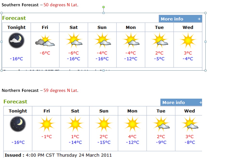

It does require fairly specific conditions to be in place like is occurring this week. Clear skies, light winds and a homogeneous air mass over the entire province. Prior to March 1 the sun is too low to have much impact and after April 1 the snowpack is generally gone in the south. So March is definitely the most likely time for this to occur.
See attached Env Cda forecasts.
