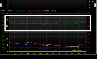

I bought a SWE3 Humidity Sensor Module from Paul at Sheepwalk and since install its been hovering, not flat lining, around 75% as you can see. Im using the RJ45 connections and providing 5vDC the same as my other sensors but not getting any joy. :? The SWE0a Temperature Sensor I also have running off the humidity board is epic if anyone needs one, :smiley: and Im sure I’ll get the humidity going too.
I have even plugged it in to the power injector by itself and getting the same results with the jumper in either spot.
Has anyone got any ideas for me?
