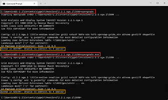

When I click the OpenGrads icon on my desktop (the target location is C:\OpenGrADS-2.2\Contents\Cygwin\Versions\2.2.1.oga.1\i686\opengrads.exe), the command prompt opens as shown in the attachment and when I press enter for landscape mode, it returns “GC Package Initialization: Size = 11 8.5” and then the command prompt window closes.

Yes, I have grads-2.2.1.oga.1-win32_superpack.exe. If you look at the offline documentation that came with the download, C:/OpenGrADS-2.2/Contents/Documentation.html, almost all of the links are broken, for example the link for “Windows” that goes to http://opengrads.org/wiki/index.php?title=Installing_GrADS_on_Microsoft_Windows returns "File not found. If you back out of that and go straight to http://opengrads.org and click on the “Windows” link, it goes to http://wiki.opengrads.org/index.php?title=Installing_GrADS_v2.0_on_Microsoft_Windows.
I’ve tried to start OpenGrADS with and without the .exe extension (see attached screen capture) and the result is the same error: Error in GXSTRT: Unable to connect to X server.
If I enter “grads” at the C:/OpenGrADS-2.2 directory, it tries to open the grads.vbs file and it returns an error on line 44 (objShell.Run ExecutableFullName & args) in the VBS script.
Bill
