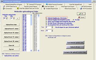

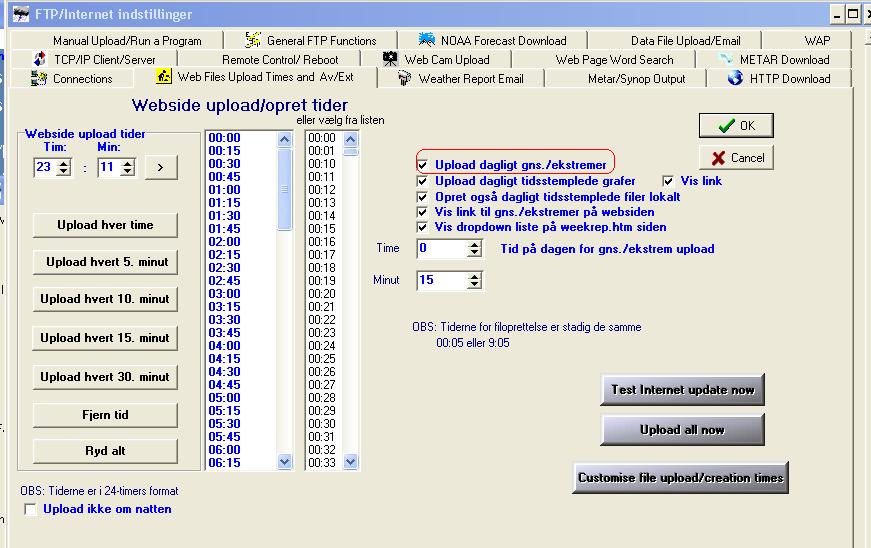

I think you have to tick "upload daily avg/extremes in the ftp/internet setup.
See attached pic.
Henrik

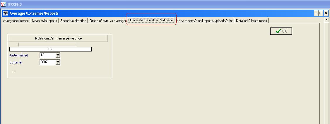

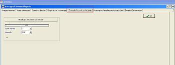

Forgot - you can recreate the average/extremes in the “View > Noaa reports”
See attached pic
Henrik

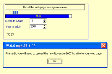

Recreating looked like it should be fairly simple, however the results were not what one would have expected… For example, I did November 2007 which resulted in strange results…
Moved to WD Bugs section. Did the same thing when I recreated December…
I have posted problems with this process in the past…and without a resolution as far as I know…I won’t touch the process with a barge pole.

were in wd did you set it to upload an how offen?
Thanks Beau
Henrik’s image attachment up higher had the info.
