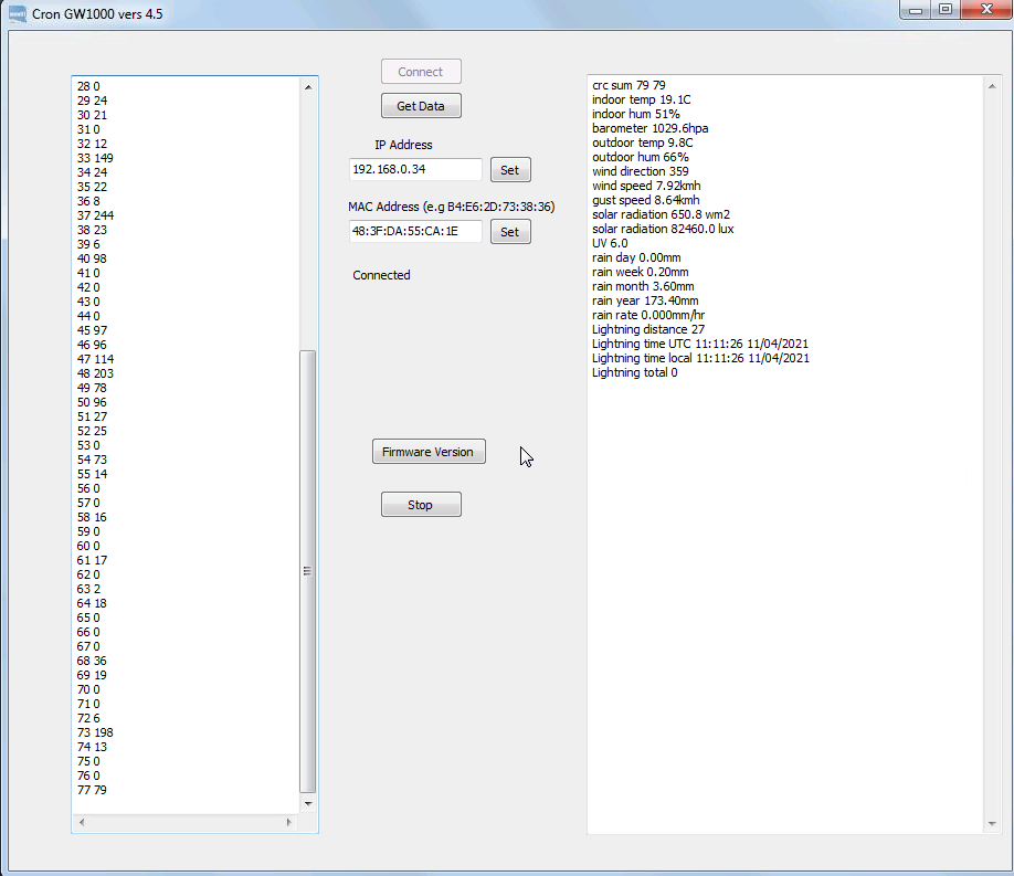

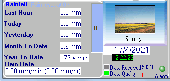

I have noticed that my WD main screen and my website (using clientraw data) is showing permanently 2.0mm rain yesterday but in fact there was no rain yesterday. Looking at the crongw1000 output window it correctly shows rain values for day, week, month and year with the correct values as 0 0.2mm 3.6mm and 173.4mm respectively. So I’m guessing that WD is misinterpreting the weekly value as rain yesterday? Am I correct? Any other users out there seeing similar?

Actually now I have read your thread I’m not sure it is the same problem. My rain yesterday issue is that it appears to be using my rain weekly total as rain yesterday. I have only had 0.2mm of rain at the start of the week and none since, crongw1000 is correctly reporting rain weekly as 0.2mm and daily, monthly and annual totals agree with WD but each day this week it has shown 0.2mm as yesterdays rain. The GW1000 does not report rain yesterday, I’m assuming that using the station rain is causing this but it should not since there is no yesterday value reported. If WD wants rain yesterday it is going to have to create the correct value in the code or create a rain weekly value as per the GW1000.
