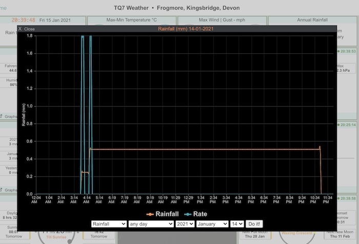

Could it be the clock in the console that is an hour ahead, so the day’s rain is reset an hour early?
A long time ago I had the “opposite” problem.
The console clock was one hour later, so the day’s rain was reset one hour after midnight, so it was counted the next day.
=D> Thank you!
There is indeed a one hour time off-set between the station and WU, which is now proven.
Check the attached screenshot of rain-pop-up for yesterday.
At 23:00 the total daily rain drops to zero.
The updated cron from my previous post is already taking care of this situation as the only script to reset the daily rain is now the cron-job.
Lets see if it works tonight.
But you have to set the console time correct, the daily rain graphs at your WU dashboard show the same error also.

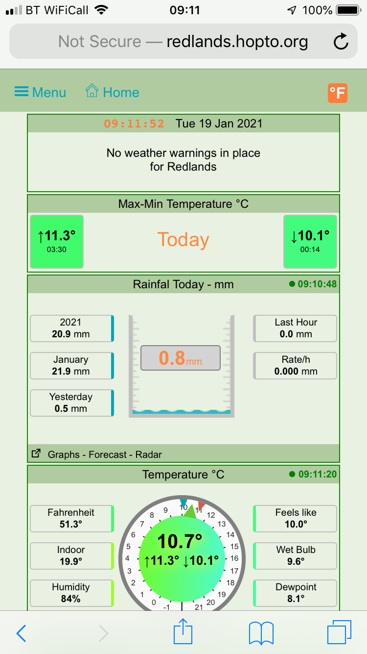

I also have a problem with my rain data in the history popup.
The total rainfall for January shows 10.8mm whereas the the graph from the rainfall frame shows 21.9mm, when totalled up.
My WU - IHAMPSHI95 - also shows 21.85mm for January. The history 2021 and and All Time rainfall totals look strange too.
My site has been running for 2 days.
Thanks for your help.
Peter
The total rain in the history is the rain from all daily rain measured since your station started and were running the station-cron.
You can update the historical raindata using pwsWD/PWS_hist_update.php?pw=12345
Replace 12345 with your easyweather-settings password.
The graphs have all the data since you started uploading to WeatherUnderground.
Those are two distinct sets of data. The graphs data sometimes contains uploading errors and is used only for the grpahs.
Those are very strange values. Use the PWS_hist_update.php script to reset those values and see what happens.
Succes, Wim
