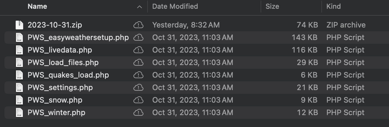

Not sure what happened but I checked settings after Wim posted his end-of-free-support message. I figured I should make sure my version was up to date and not worry about it anymore. So I go into settings and do the check for updates and it shows me a few files need to be updated so I download the zip file. Here’s the list:

I then ftp these files to my server using filezilla to overwrite the old files. All seems ok, but when I go to look at my website all I get is a 500 error. Huh?
(add: by replacing the files one at a time I find that the PWS_settings.php file was causing the 500 error)
