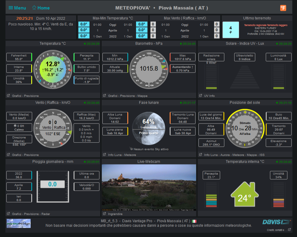

Hi all, I downloaded and uploaded the pws dashboard, everything works except the min / max values of the small temperature block and the wind gust. I attach image to clarify better. I use the meteobridge realtime.txt file. What do I need to do to get everything running smoothly? A thousand thanks.
did you setup the cron job
. . . and please provide URL of your site.
No , just use the realtime.txt . All is ok ,the graph too , just the min/max temperature…
you need to setup cronjobs for those to work
Thanks for the reply, I’ll try to set it up.
More information here No High/Lows, where is history and graphs data used for, and cron ?
