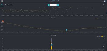

@Olicat done…
And fixed:
Many thanks again!
