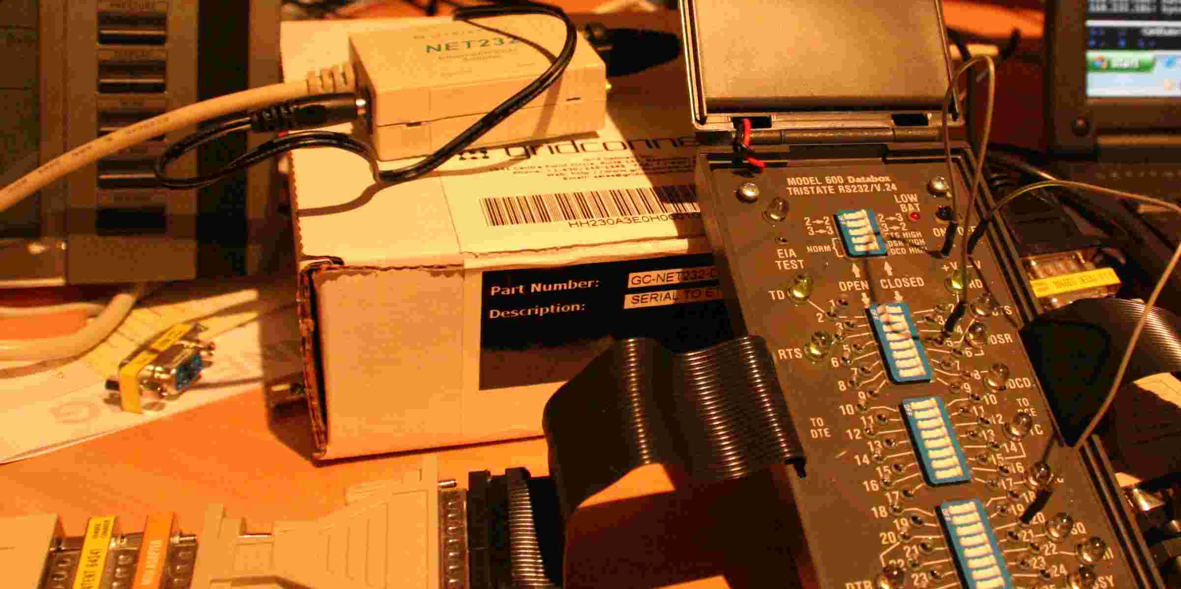

I brought some Serial stuff with me from work, bob a few gender and null modem changers. A borrowed weather station 2300. Trying to perform some stuff, i discovered that placing a perm -V (It’s a Pin in the BOB) on pin 20 of the WS-2300 is enough for letting it to starttransmitting data to the Computer! So it doesn’t need a connection to the net232. So I only have BOB pins 2,3,4 enabled from the DB25 Pinned BOB, and a -v on Pin 20 at the WS2300 side.
The biggest trouble I have right now is the Speed it all operates. I have found nothing on the “quirky” LaCrosse serial protocal about speed, parity and stop bits… Most time 9600 8N1 is good.

I performed following:
  • Placed a serial Break Box between WS2300 and PC Com1 for reference
  • Checked the lights and find out the least nessesary pins
  • I first got 4 pins, TD RD DTR RTS all on the left side of the Breakout box (Left side is the DTE Side where the PC on Com1 is connected, on the right side the DCE part is connected to a laCrosse 2300 Weather Station)
  • When the La Crosse is in action with the Heavy Weather software RTS is solid red (when no software is running it is green)
  • DTR is allway’s green
When trying to perform this with the NET232 Virtual Com4 to the same pc i didn’t get the green light on RTS and the green light on DTR :frowning: Tried several Baudrates etc.
End solution is as follows Took me 5 hours :frowning: (not counted the other day’s I was searching) :
  • place the LaCrosse 2300 at the DCE side of the Break out box (Right Side)
  • place the net232 on the left DTE side of the break out box
  • On the break out box I only enabled allowed jumper 2 and 3 (Td and Rd)
  • On the right (DCE / LaCrosse WS2300) side I placed to wires:
    – 1 from the +V to pin 4 of the BreakOutBox
    – 1 from the -V to pin 20 of the BreakOutBox
  • Now I place the NET232 in 2400 Baud 8N1 NO Flow controll what so ever no adjustable pins etc
That’s it it run’s!
Now the problem, I want to have this setup running without the BreakOutBox :slight_smile: I came accross a forum which said the LaCRosse uses a bit of power from the serial connection to work. This power should now come from the NET232…
Can Someone explain what I did? With those +v en -V , are those stable straight volts ? or is a a Clock signal of some kind? I Included a Picture so you can see the setup, JPG compression is a Bit low because of the limit for file posting.
I Hope someone can tell me how to trick the Serial connection without using the Break Out Box, the break out box I’m using has power for itself with a battery.
Thanks everybody for the advise so far!
Regards Tom, going to an angry Wife in the middle of the night…

I have the working solution:
The WS2300 use the RTS DTR as power supply for his RS232 driver circuits, so you need to provide those voltage.
I have a Lantronix UDS-10 RS232 to Ethernet adapter, called terminal server.
It is working nicely. A little modification is needed to get correct voltages.
If anybody is interesting, I can give the exact cabling / modification…
