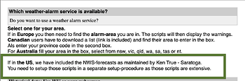

All NWS-alerts settings have to be made in the appropriate script
. . . pwsWD/nws-alerts/nws-alerts-config.php
The PWS_Dashboard scripts do not alter any nws-alerts script.
They only read the data as fetched by nws-alerts/nws-alerts.php
Please read the original …/nws-alerts/NWS-alerts_read_me.html about running an extra cron job if you have more than a few areas.
The pwsWD staion-cron job only process pwsWD/ scripts, so you need an extra cron in that case!.
