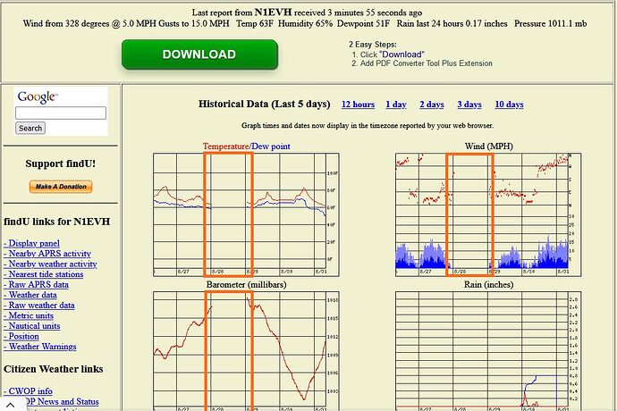

Here’s what I see for the 10 day graph at findu:
It appears barometer data is there but I can’t view the raw data from the 28th to confirm.

If you look at the 10 day graphs… then yeah… it “appears” as if the barometer data was sent. If you look at the 5 day graph… there is a 24hr gap in the data… just like with the temp, dew point, wind speed, and direction.
When I scroll back in the graphs… its appears that my Weather Display DID receive data from my weather station… its just for some reason… my laptop DIDN’T send the data to CWOP over the internet.

here is the 5 day graphs on FindU that I just did a screen capture on… showing that no data apparently got send to CWOP on Sunday.
You can see the “gaps” in the received data in the temp/dewpoint… the wind speed/direction… and the barometer.
When you look at the 10 day graphs…
You can see the gaps about every 6 days (not sure why the barometer gets filled in on the 10 day graph… but shows the gaps on the 5 day graphs).
