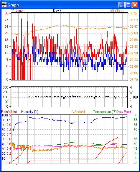

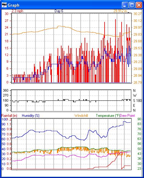

One graph with WD in listen only mode, the other with WD in control. Judge for yourself…
