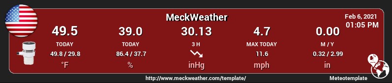

Now I see what you meant.
That is often used as a signature on forums a.s.o. or as a advertisement on local websites.
Be aware that it can increase the load on the website considerably.
F.i. when you have multiple posts on a page each signature on that page is loaded separately.
3 or 4 answers on a page * so many visitors browsing that page can add up.
You should better cache the generated html and return that html for 5 minutes or so.

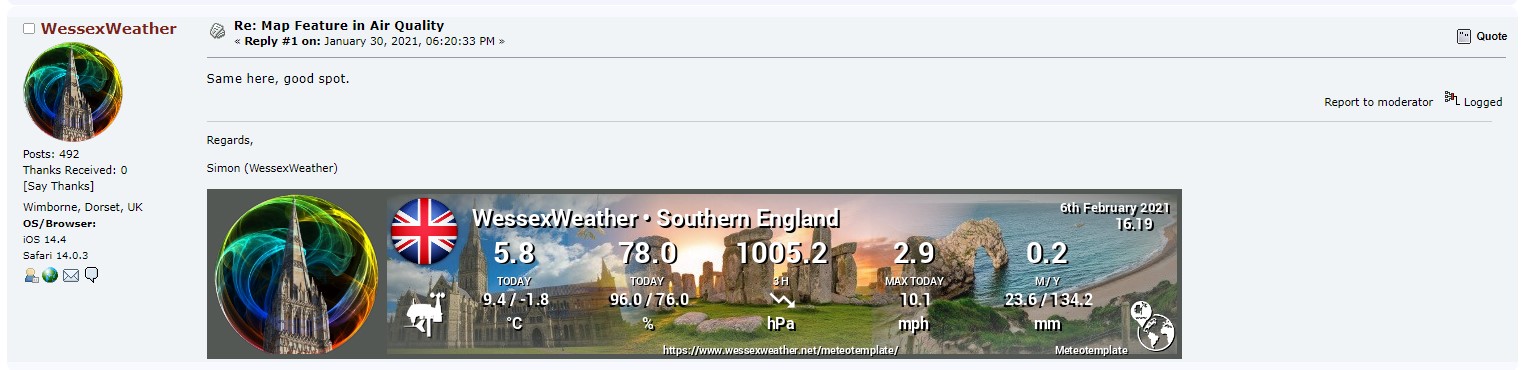

WessexWeather is using his meteotemplate sticker as his signature already. Perhaps he can share his secret.
That one is generated by a standard Meteotemplate script .

I know him well. I just can’t seem to get the BBCode right in order to display the image.
So I was not doing anything wrong, but urls in signatures that do not come from secure servers are ignored.
To get them to display be sure you use ‘https:’
