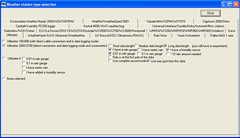

Attached is the way the I have it set up after our last discussion. I’ve not seen any FAQ or information on what the setup is recommended to be. Do you have any users that are also using a Peet Bros system with Wdisplay that would, perhaps, share a screen shot? I hate to “guess” at what the settings should be.
Something that may be tied into this, if I click on the “Rain Today” in the lower left corner, and correct an entry, should it not correct the entry for the day and show up in all subsequent images and data displays?
Fred
Fredy - I also have an ultimeter 2000. I notice your configuration has 0.1 rain gauge and *10 both checked. What is the diameter of the rain gauge attached? If it is the large (approx 10 inch diameter) black one, you should have .01 gauge selected, and *10 unselected. I also have selected for my ultimeter 2000: long data length (you may need to experiment for this), and I have set mine to “data logging mode” (press and hold the “-o-” and windspeed keys together for 3 seconds to select this mode)
Here’s a screenshot of my configuration screen:

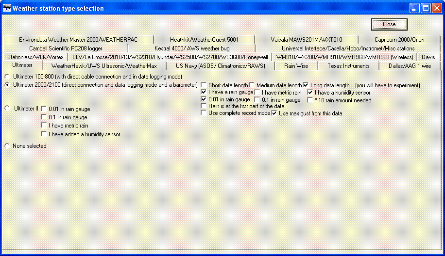

the rawultimeterdata.txt shows that you actualy have the ultimeter in complete record mode instead of data logging mode, and so you need to set WD to use that in the weather station type setup, or change the station to send in data logging mode
I wonder if my old thread is related http://discourse.weather-watch.com/t/11906
Complete record mode
Long dat length - checked
.01 - checked
*10 - checked
but
in Offset 158 5% for the rainfall
cheers
I’ve got both Ultimeter and Wdisplay set to complete record mode, per a suggestion posted in the forum.
However it doesn’t seem that Wdisplay is picking up any of the data. Note the link provided below. You’ll see that we come up to the 5th of this month and now NO data is being recognized by Wdisplay.

it looks like you actualy have the ultimeter set in comlete
record mode and so you need to select that in WD in the
weather station type setup and so that will be what the
problem is Cheers Brian

After all the changes, here is where I stand.
  • Rain gauge is a ultimeter pro rain gauge. Master unit is an Ultimeter 2000
  • Ultimeter 2000 is set to “long data length”.
  • “Long data length” is ticked.
  • “I have a rain gauge” is ticked.
  • “I have a humidity sensor” is ticked
  • “0.01 in rain gauge” is ticked.
  • No other items are ticked.
