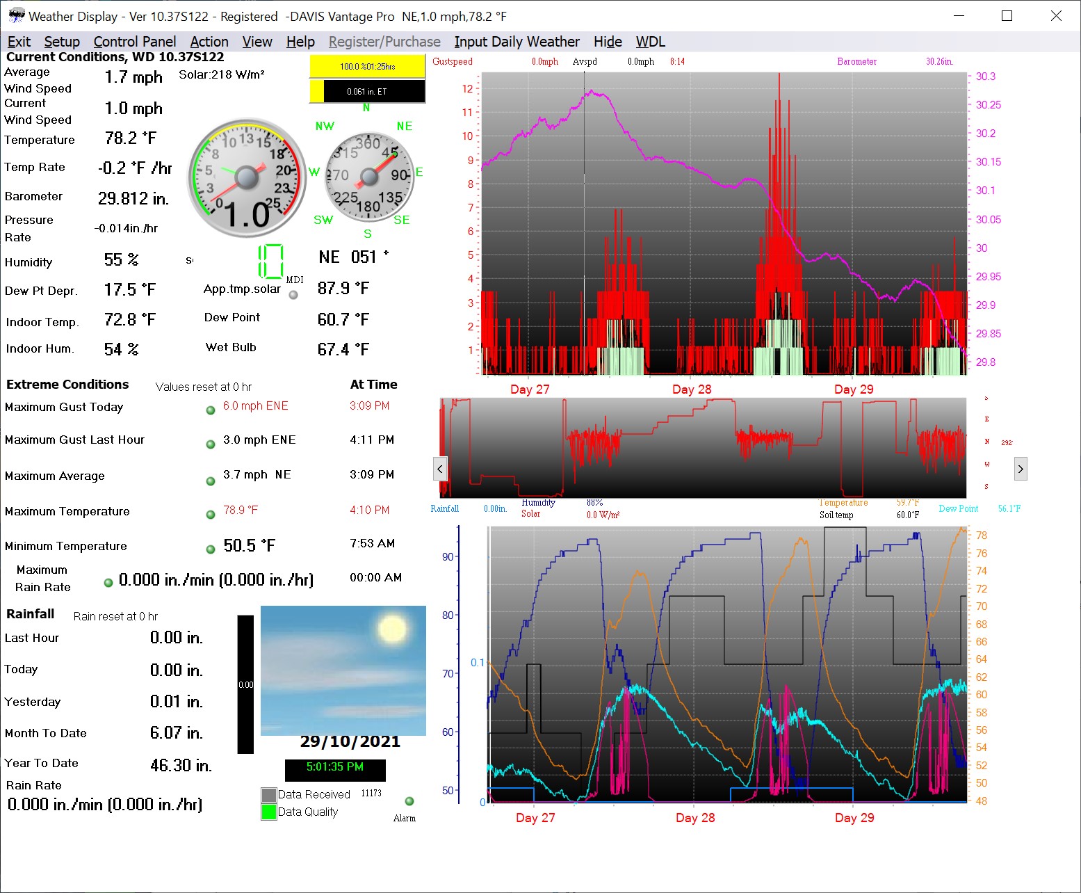

On the main screen underneath the wind dial I get what I think is current wind speed in a large font obscuring other readings. I have tried all of the settings to try and switch off this(as it is also shown on the dial) with no success. Anyone got a clue on how to do this? Im trying to get my soil temp and soil moisture to show up on the main screen and I think current wind is blocking soil temp.

see attached

From what I see, the soil temperature is partially obscured by the wind gauge.
You will need to reduce or move the gauge up.
Soil moisture is not available for the main screen but maybe it could be added.
yes you can move and resize things on the main screen and or set to not show the windspeed reading (the LCD value) under the windspeed dial
