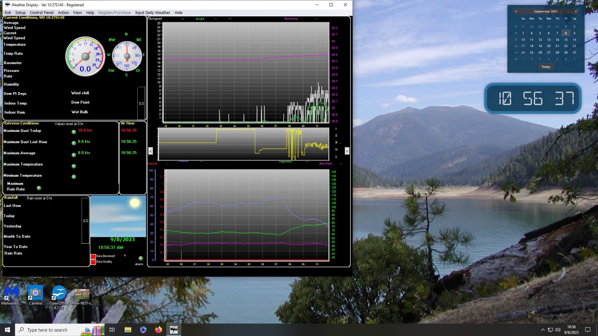

OK what happened?
Ok got up this morning and went to check the weather, all I got was the display in the photo below.
What the heck happened? I have tried the backup wdisplay ini file and still get nothing, anyone have an idea on how to fix this??
Looks as though it’s not recognising a station: top line usually gives the station type after “Registered”.

Well I had to reset the comport, and the location latitude and longitude, but the background color is wrong, and all the other settings I had for WD have changed, it’s like the program reverted back to when it first was loaded.
This is what it use to look like.
This is an old photo.

Look at the photo in my first post, 10:56:37 on the 8th of this month, WD is set to come up when the PC is booted up, all was well before i shut the PC down the night before. And I did a save before I shut down WD.
