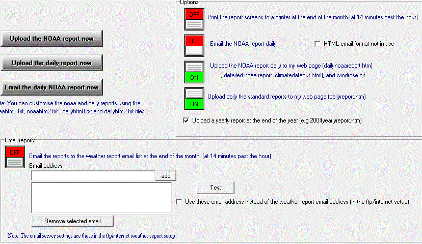

make sure you have set to upload
the noaa and detailed climate reports
in the view, av/ext, internet options

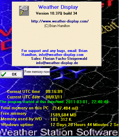

Sorry, I’m using the latest version 10.37Q b34 but not with todays date :wink:

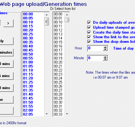

Attached my settings also. Like I mentioned no problem when manually triggering an upload

the daily av/ext is updated at 8 minute past the reset hour (e.g 00:08)
the detailed noaa and climate report is updated at 11 minutes past the hour you have set for the noaa reset hour (in the view/av/ext, noaa report, setup noaa report)

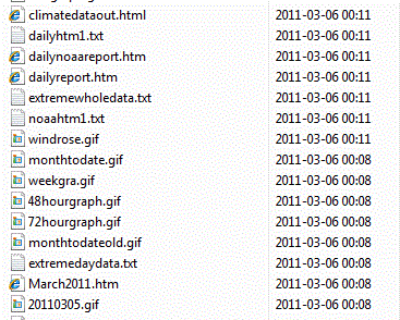

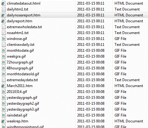

I saw a change in build 35 where you removed the field Minutes (after hour) so I guess the creation times are more hard coded now. Still, my files are created like clockwork at 00:08 and 00:11 (file below) where the later are not uploaded.
