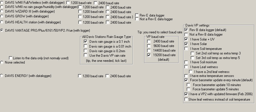

Here is a graphic of what I have configured and what I am seeing.

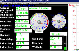

the screen shot shows 13mph though, and not 15mph?
can you post the rest of the screen shot, e,g the graph as well?

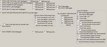

Unrelated but you have the Davis rain gauge size set incorrectly. You need to follow these steps, first uncheck 0.1 inch, then check 0.01 inch.
Ok, Made the rain gauge change. I also (beforehand) removed 10.37P and re-installed from scratch and that fixed my wind problem. :smiley:
