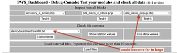

The distorted PWS_module_test.php is caused by the very long “names” (aka long URL’s) for the pop-ups.
I will change the script to cut the “names” short.
Having to scroll the browser window because the drop-downs are to wide :slightly_smiling_face: , that is something I did not expect to happen.
Attached a test version, it should shorten the description of popup’s (top right ) and filenames (middle row left )
