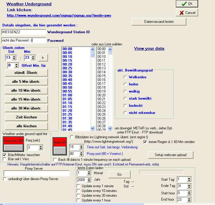

I just installed last Version of WD (Trial) and so far if I want to manually update my data on weatherground, everything works fine.
I want to update my data every 5min (or do you suggest other intervals?) but the timer on WD doesn’t seem to work at all. There is no automated update.

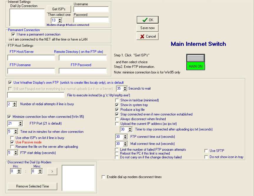

You would need to have the “Main On” switch turned on in your WU setup page, and for almost realtime updates (Rapid Fire) you would set Real Time to On as well…
Hey there, the Mainswitch is on, rapidfire is on aswell.
Funny thing:
With Mainswitch AND Rapidfire on I have an update every 5 min.
if I disable rapidfire, NO update is done…
if I set the interval to 15min (should be enough!) it still stays at 5min update intervall…
WTF??! 8O
With RapidFire I believe that WU automatically lists Tabular data for every 5 minutes regardless of any settings you may have.
Sounds plausible, well if WU doesnt care about data income I dont bother too much. But still I wonder why it does not update in 15min intervall wenn I shut down rapidfire.
