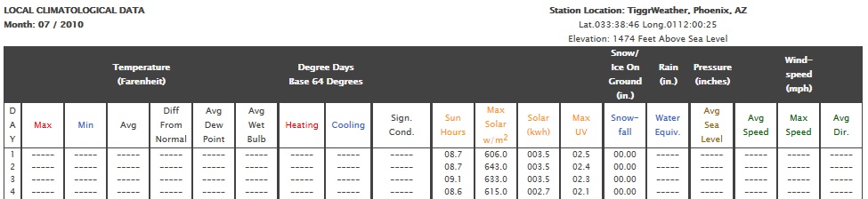

Brian, tried a number of the blank dates I have showing. The files were created, but are essentially blank as far as data is concerned. Please see attachment (it’s the same for all I tried and for the full month - didn’t want to waste the space).
try converting that months logfile to date file
(there is now a youtube video on that)
