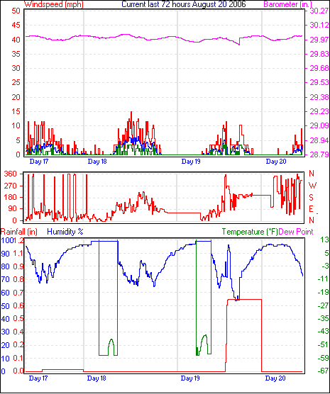

In the last 10 days I have just replaced a LaCrosse 2010 with a Vantage Pro2+ and already I appear to be having a problem. I believe it to be the sensor in the ISS as the false reading is shown on both the console and WD via the Weather Envoy.
The outside temp. has on 2 occasions fallen to -56.7F, but it does not ‘flatline’ while the problem is present, it also shows temperature variations as can be seen in the attached image.

The scale on the temp graph is way off. You have it displaying 13 to -67. It is all off scale.
–Dave
Bob, just realized that the screen shot you posted was for the last three days. I just checked you web site and see this is not occurring on the main screen. No sure why the past days graph would have a different temp range.
–Dave

Dave, thanks for the responses, but it’s nothing to do with the graphing, it’s a hardware issue.
